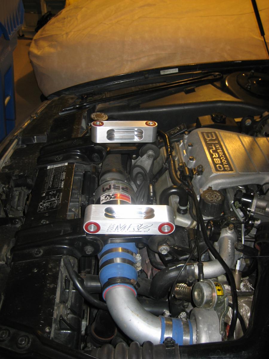

EMNCFI Posted November 2, 2010 Author Report Posted November 2, 2010 Todays work: Went through the whole car today trying to chase down what I think is a bad ground. I pulled off the negative cables and took the battery out while I was at it to get at the ground on the block. Found that my battery is leaking. Took it out, then had to wire brush and grind down any corroded metal and repaint it. While doing this, my new dog bones arrived. Got the grounds all cleaned up and making good contacts, battery should be in stock tomorrow. Quote

EMNCFI Posted November 2, 2010 Author Report Posted November 2, 2010 (edited) So far yes, and the grounds that ran from just next to the battery hold down to the transmission/block. Still have a hum and strange static on the radio though, which is what I am trying to fix. Have a second radio and it has the same problem. Also, anyone else running these MRZ dogbones, since in the car seems to rattle and vibrate more at idle, which I suppose is from the new dogbones having a harder brushing in them. The new ones were about 1/3 inch shorter than the stock so I had to pull by hand on the engine to get the holes to line up, but as I said, I could do it by hand, and only about 1/3 inch I can't see this being a problem, or could it be bad? next weekend, lower mounts  Any other grounds I should do Edited November 2, 2010 by EMNCFI Quote
Garrett Powered Posted November 2, 2010 Report Posted November 2, 2010 no, sounds like you got the good one, right next to the battery tray, runs under the turbo. what size wire did you use there? if you mean the stock radio making the static, that is what they do after awhile. the red tgp (same exact mileage 111k) started doing it so I started getting it setup for a aftermarket system. it was neat having the stocker in there for awhile, but now its gotta go. Â I am not sure about the dogbones, I have never seen that style. 1/3 " does not sound too bad. Quote
EMNCFI Posted November 3, 2010 Author Report Posted November 3, 2010 Haven't actually replaced any wire yet, mostly just cleaned up the point of contact on the car. The dogbones are from a place in Canada, they are really tight, the engine does not even move slightly when you shift it. I did not think the movement would be bad, and really saying 1/3 of an inch is probably overestimating it, it probably was less than 1/4 inch  Anybody got some good ideas on the lower mounts, I know autozone has solid rubber ones, and then there is the OEM hydraulic ones, any others that top those 2 Quote
slick Posted November 3, 2010 Report Posted November 3, 2010 The symptoms you are getting with the dogbones sound about right. Much harder bushing material, so you will feel more vibration. Quote

EMNCFI Posted November 5, 2010 Author Report Posted November 5, 2010 Motor mount recieved today, had to go hydraulic, as I could not find a solid rubber one, autozone had them, but the "supplier inventory was at 0" which I take it as they are not made anymore? all the same, the hydraulic one has not been replaced in 20 years, so if its a once in 20 thing, I would say I am good. my transmission was replaced at 80K which was about 30k ago, what do you suppose are the chances my transmission mount is fine? Quote
