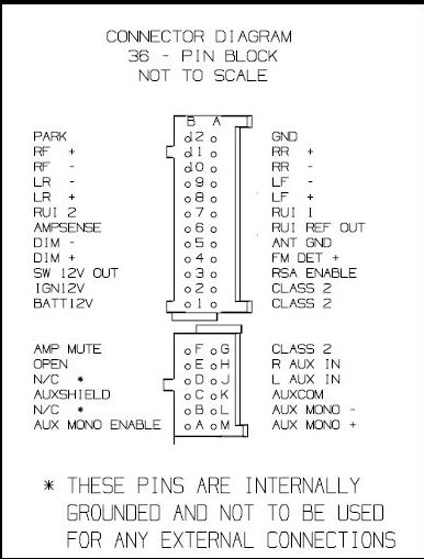

Starflare5 Posted January 2, 2010 Report Posted January 2, 2010 (edited) Hey there, This could be exactly what you need: I hope this helps you, Starflare5. Edited July 5, 2011 by Starflare5 Quote
