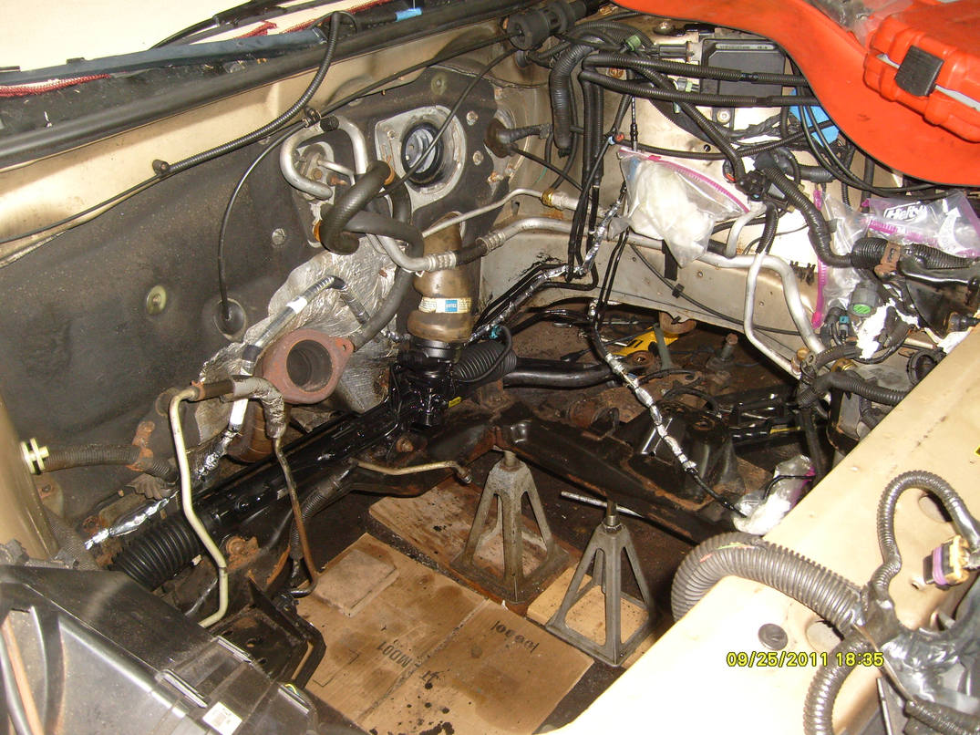

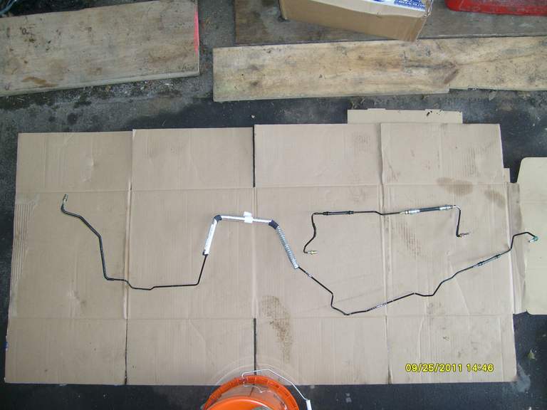

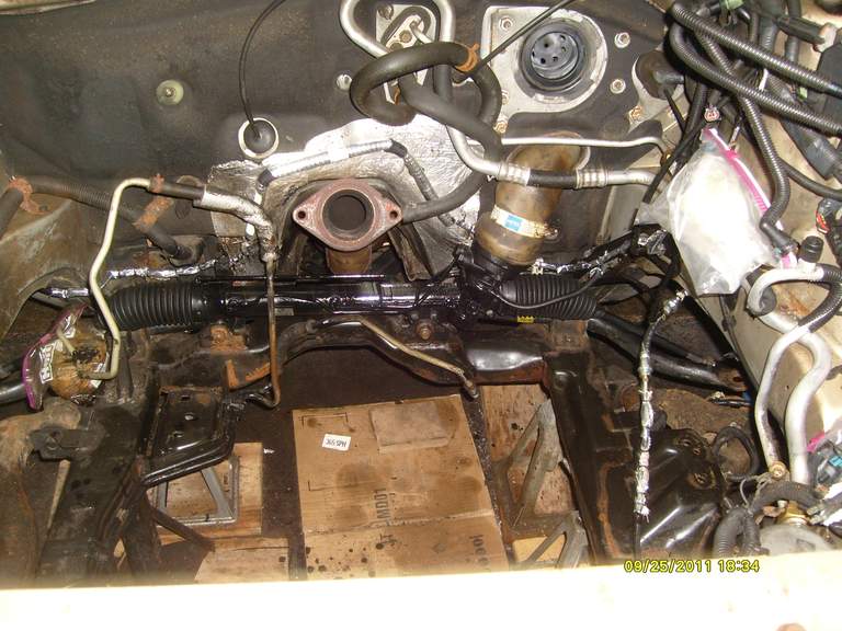

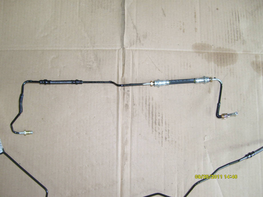

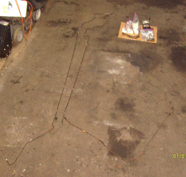

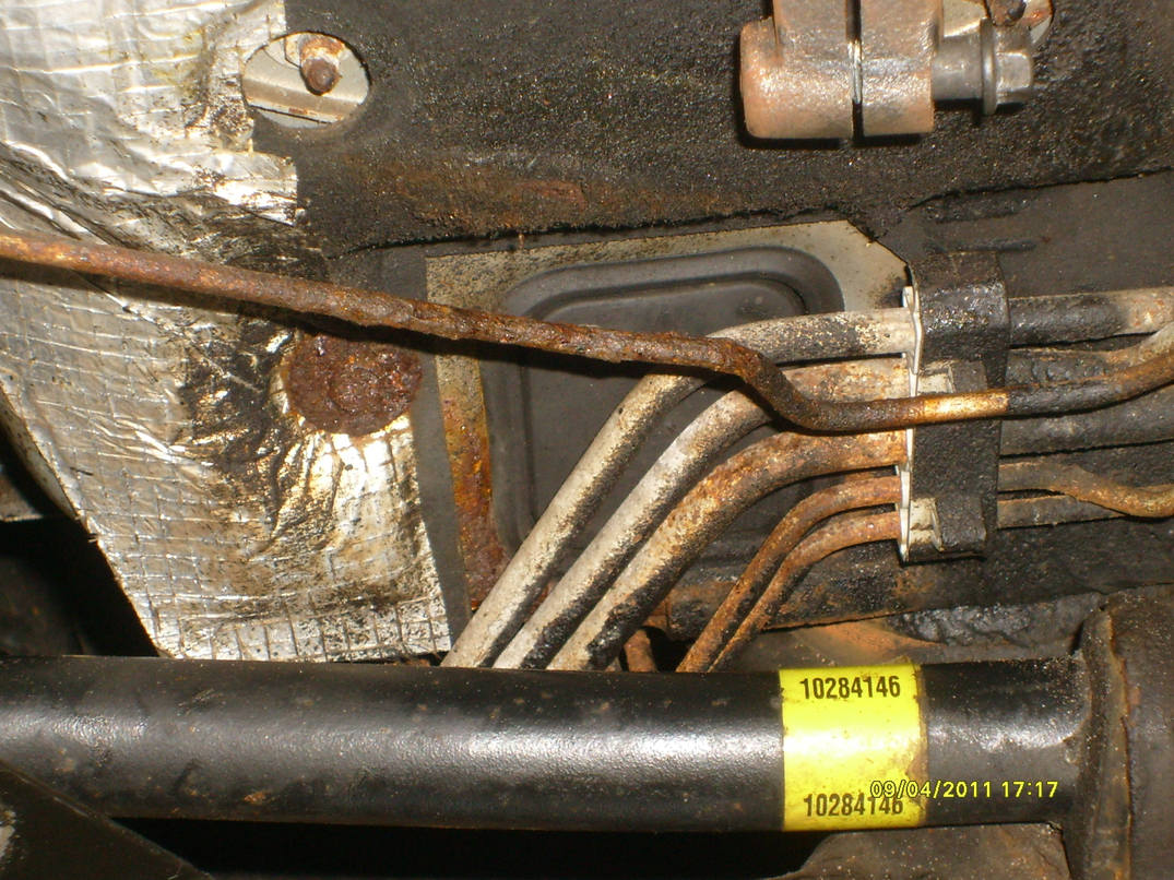

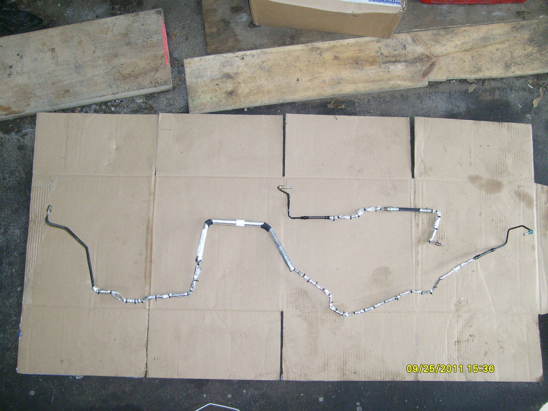

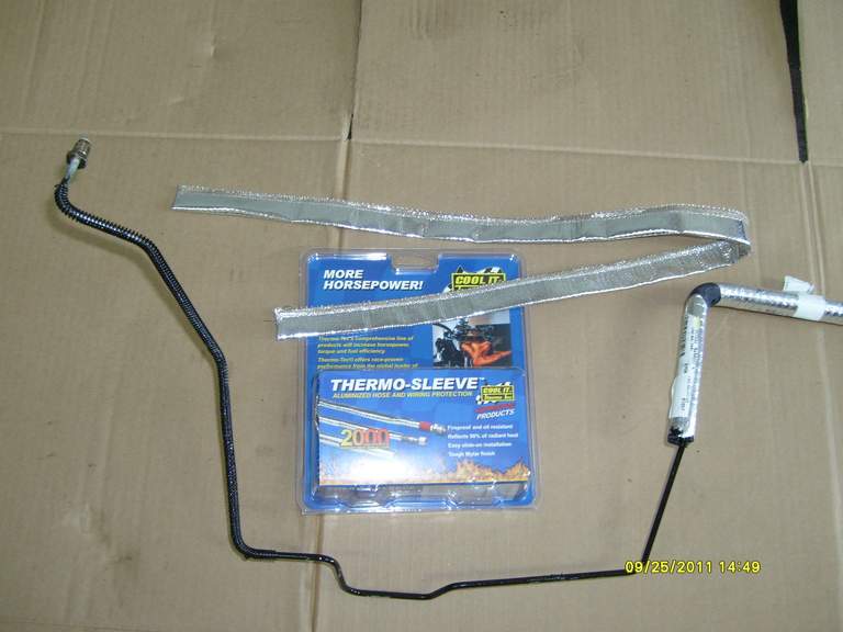

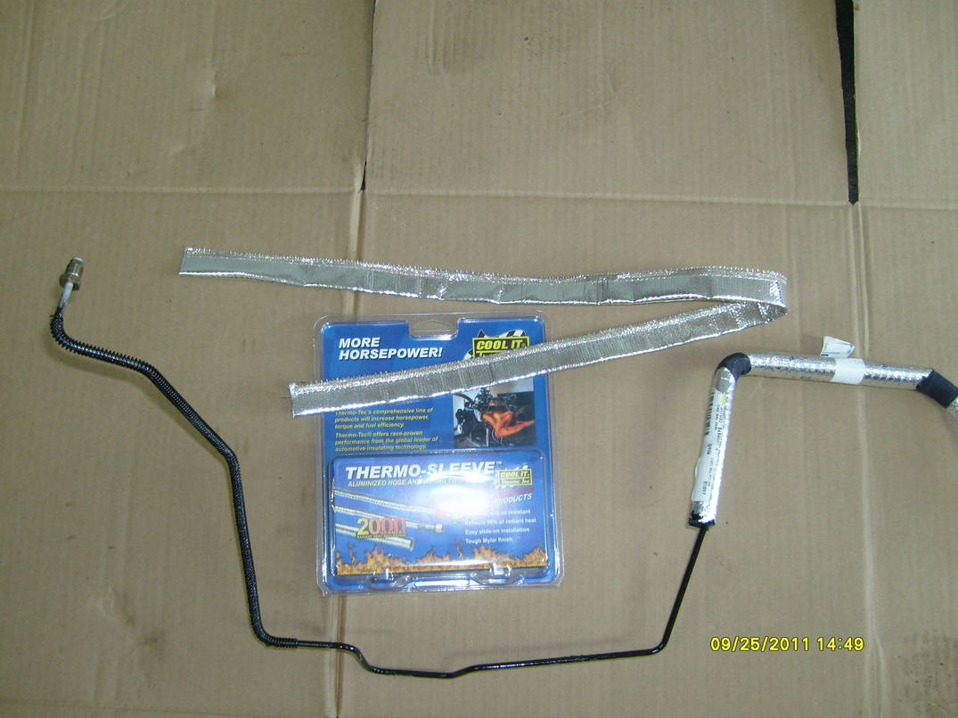

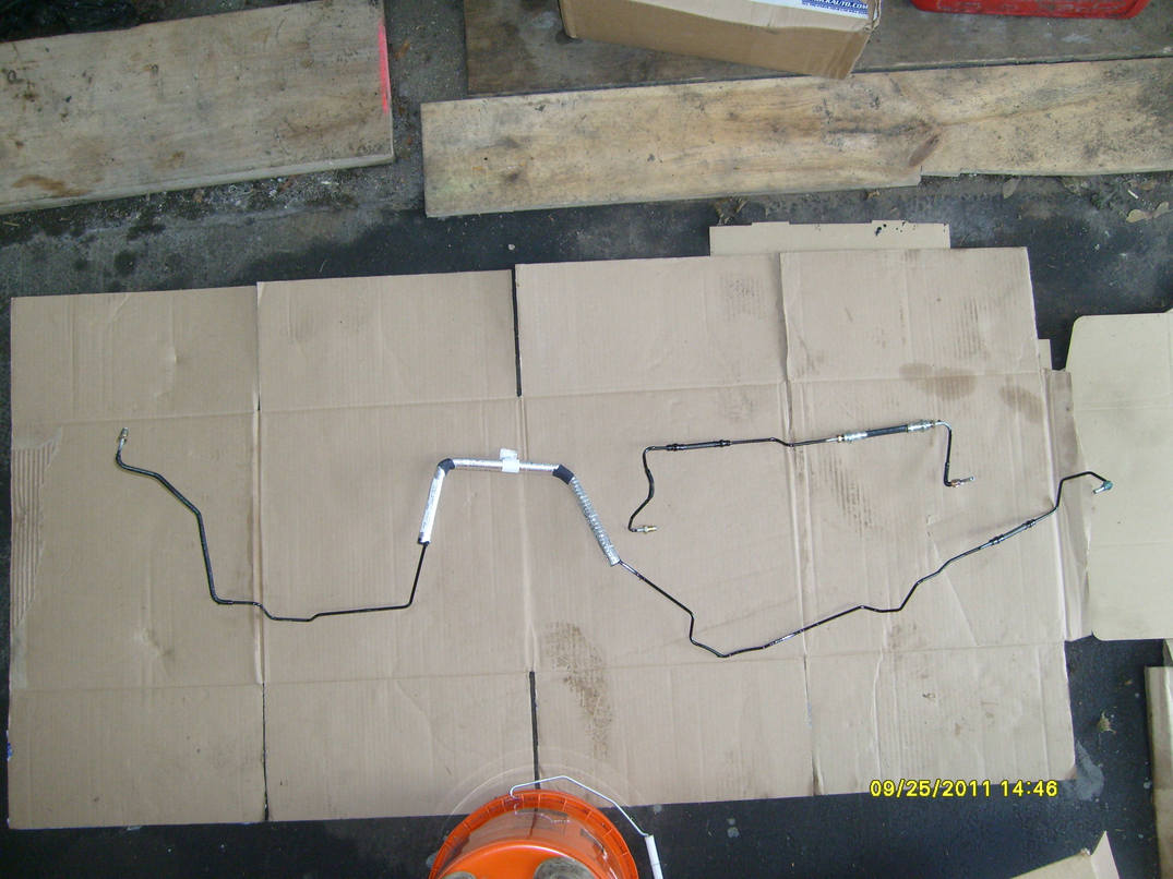

I've replaced all of the brake lines in my '92 Achieva and my 2000 Intrigue. For the Intrigue, I got as many of the lines from the dealer that they offered.
Also, to be clear, there are "rubber hoses" in the brake system. There are hoses for the calipers, and some of the cars have a brake hose and hardline single unit brake line - like the lines coming from my ABS unit on my Intrigue. That way, it saves space and is a beter design than using coils to allow for the ABS/MC to body flex.
Time for tons of pictures :):
For my 2000 Intrigue:
I coated the new brake lines with POR-15, and I used Thermo-sleeve on the from brake lines to help protect them from the heat of the exhaust manifolds (that are very close to the brake lines in my Intrigue).
Note, the pictures are not shown in a time-wise or great order.
Good Luck!
