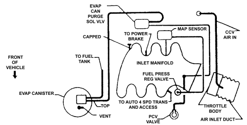

Red95GP Posted November 5, 2008 Author Report Posted November 5, 2008 just tried that and idle seems unafected. Still has a rough idle. Im not sure if I did it right though. I pulled 2 fuses that were marked ECM IGN and ECM BATT. I popped those out for about 20sec with the car off and then put them back in and it started normaly and I put it in drive right away and followed the procedure. I found a 90* rubber elbow coming out of the firewall on the passenger side and it seems like it had a hose connectedd to it but it was chopped off. The previous owner said it had a rebuilt motor so possibly they forgot to attach that vacuum line. but where does it connect to on the engine? I saw this diagram on autozone.com and the one that seems like it goes to the same spot is the one coming from the evap canister and going to the fuel tank. I dont see any canister type thing on my car though. Anyone have some pics of what it is? Quote
Night Fury Posted November 5, 2008 Report Posted November 5, 2008 It is really obvious once you see it... It is like a huge pop can or something. Has lines coming out of the top of it. Quote
Red95GP Posted November 5, 2008 Author Report Posted November 5, 2008 the only thing that looks like a pop can under my hood is under the air box next to the battery and it has some metal lines running to what i think the a/c compressor. Quote
Night Fury Posted November 5, 2008 Report Posted November 5, 2008 It should be like by the passenger side fender... Quote
