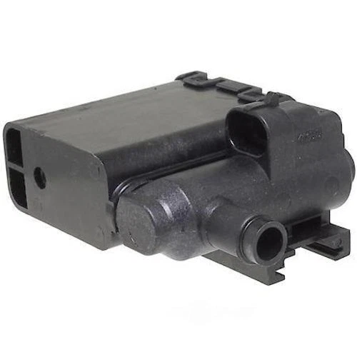

why cant i find a canister purge valve for a 1990 regal 3800 anywhere.i can find it for a 1993 and up or 1988 and back.cant find it for 1989  1990  1991 or 1992 no where gm or aftermarket. thanks.can i use one for a 1993.

Can you guys be more specific?  What canister...for the one at the rear of the car I'm guessing?
Sorry if you know this already but the part # from GM is 25536881.  No NOS ones are available anymore.
Now, there is this one being available and showing that number of 25536881 being interchangeable with it so maybe this is the aftermarket replacement.
Vapor Canister Vent Solenoid CARQUEST CPA1116 - Picture 1 of 1
https://www.ebay.com/itm/354437432150?epid=4045192223&itmmeta=01HYGXZGPHA0FR1PERRTDQ5AM6&hash=item52861e0356:g:UrUAAOSw9lNlxrF2&itmprp=enc%3AAQAJAAAA4J0fTXa61Yuya6JQSHsCCPxtoeHQnPz3ZI6WLg5rYoFMxuA2402vcBFI4seeitcqJHwtOBAlPT%2Bt0PlzIGMXoFbpfNXJdVXJsFF66anjozJYd%2BXp8m2JEg7ojzHxPxU%2FoSaIG%2FXUW95rLHFRoqbvdXsht8utd7Mxi25EB4LhTYXvCWJNlFheI0IUP4V7wxsh56JKBKtK2KXYIORCb1LeWKq70gIWKBW1TDs7Obvzw2J%2BYtgwsyKRSlmafalXMPgsCEBzbZOC7oBr%2BBCB%2FqjjM6cLgrQulmyOz5M8JoSYLlyr|tkp%3ABFBMpov-nfRj
