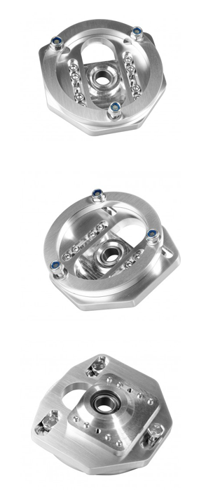

Imp558 Posted October 19, 2015 Report Posted October 19, 2015 It looks like there's a bunch of companies making these for BMW E34 (5 series), they're pretty close looking to what a first gen would need and inexpensive, I'm thinking maybe drill new holes. Anybody have access to a BMW 518, 520, 525, 530, 535, 540 to measure the bolt radius? There are some all aluminium, and some with a steel bottom plate, these cars weigh a bit more than ours. http://whatiscurbweight.com/vehicle-weight/bmw_curb_weight.htm http://www.ebay.com/itm/BMW-E30-E34-E28-CAMBER-PLATE-3D-CASTER-COILOVER-MOTORSPORT-DRIFT-PRICE-PER-SET-/181165402528?hash=item2a2e4ca9a0:g:UkoAAOSwoQ1TmsoP&vxp=mtr Quote
Imp558 Posted October 25, 2015 Report Posted October 25, 2015 This looks pretty good already. I spent the day in a wrecking yard and made cardstock templates on an 88 and 98 BMW. Both of them appear to be just under a 6" bolt circle but I didn't measure them yet. I marked the bolts, center of the strut, and center line. I'd feel better making a plate of 1/8" steel for under the tower since they are a bit smaller. I'll know more when I template mine and overlay them. So far so good. Quote
Imp558 Posted February 2, 2016 Report Posted February 2, 2016 I made a little progress here, "little" being the operative word since work is crazy this time of year. The concept of using E-bay top plates for cheap doesn't seem challenging and if it doesn't work there's another solution or 2 on the horizon so I turned my attention lower. I won't have anything I like under them unless I make some changes to the struts so I went on a mission to convert to Gen II knuckle assemblies to get real McPherson struts up front. The idea was to make a plate to fit the ball joint upside down on an A-arm since the G2 knuckle needs the tapered shaft part to go into it (opposite the G1) I ordered a Gen I A-arm and ball joint so I could have shiny new parts in my hands and quickly realized there was no welding a plate to it and mounting it upside down possible like I was hoping. Not a day later I did a favor for a fabricator I know and when he came to the shop to pick the job up I presented him with the problem and he immediately said it wouldn't be a problem to make a jig for spacing and cut/weld to end up with a Gen I A-arm that has a Gen II grafted onto the end. A little more money in the bank from now I'm ordering another A-arm and either bead blasting the Gen II ones I have or ordering them too. To start I'll put a nice set of Koni struts or something up there but later having the McPherson mounts opens up the possibility of putting in that cool auto dampening system the SSEI came with..... much later since that system STILL doesn't work IN the SSEI I have to study. Quote
