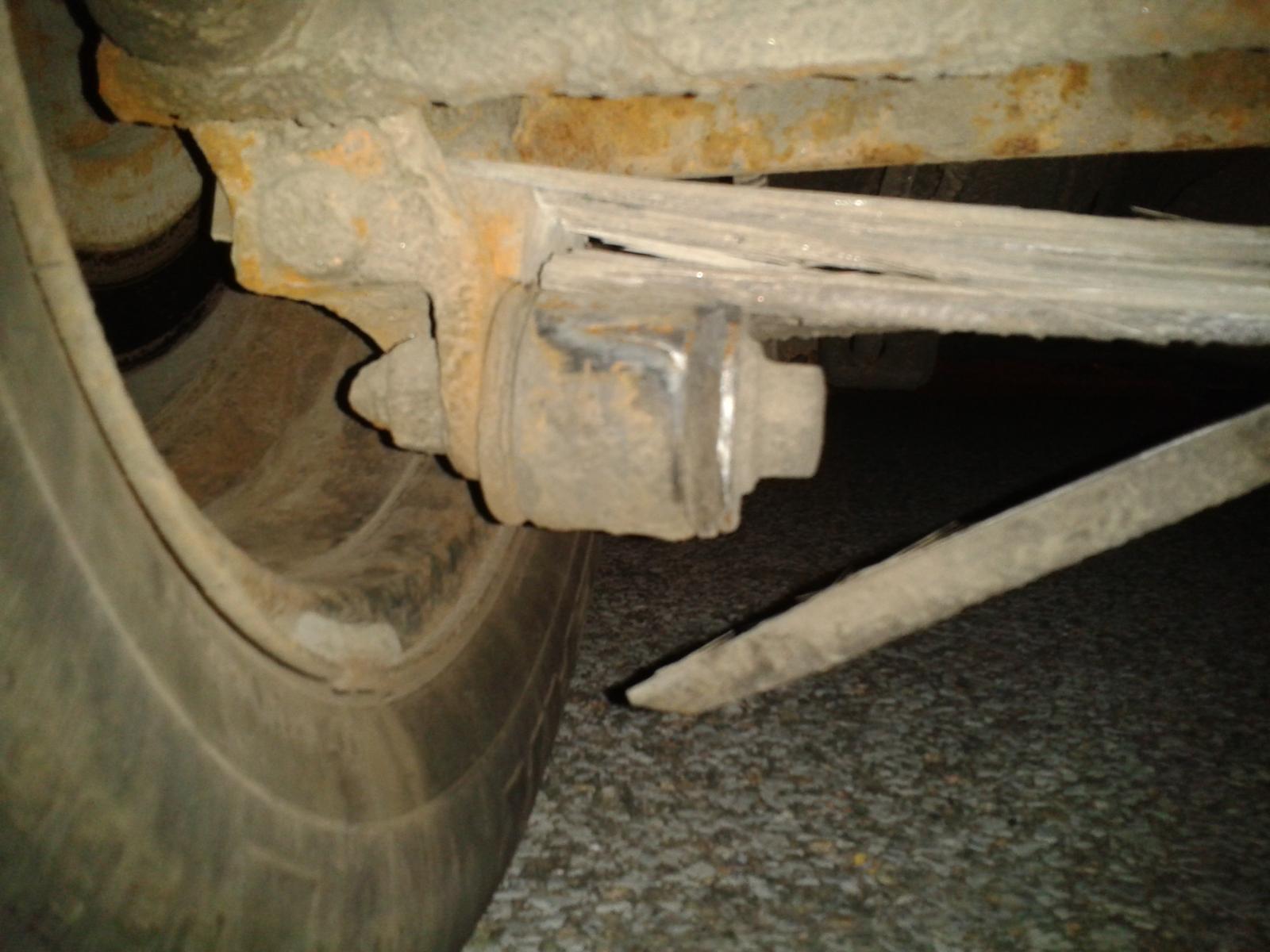

Buick666 Posted July 27, 2013 Report Share Posted July 27, 2013 Yeah well.. the monoleaf is dead on my car... it's about to pop off the control arm. So coilover swap is going to happen sooner than i thought. Quote Link to comment Share on other sites More sharing options...
Buick666 Posted July 28, 2013 Report Share Posted July 28, 2013 Here it is... it's pretty much dead. Quote Link to comment Share on other sites More sharing options...
