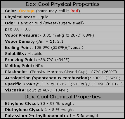

Timm Posted August 26, 2008 Report Posted August 26, 2008 Pro's and Con's for each. Any high-mileage benefits? (Move post to liking) Wow, those both look really nice. I might get my car painted Dexcool Orange, or Antifreeze Green. Quote
