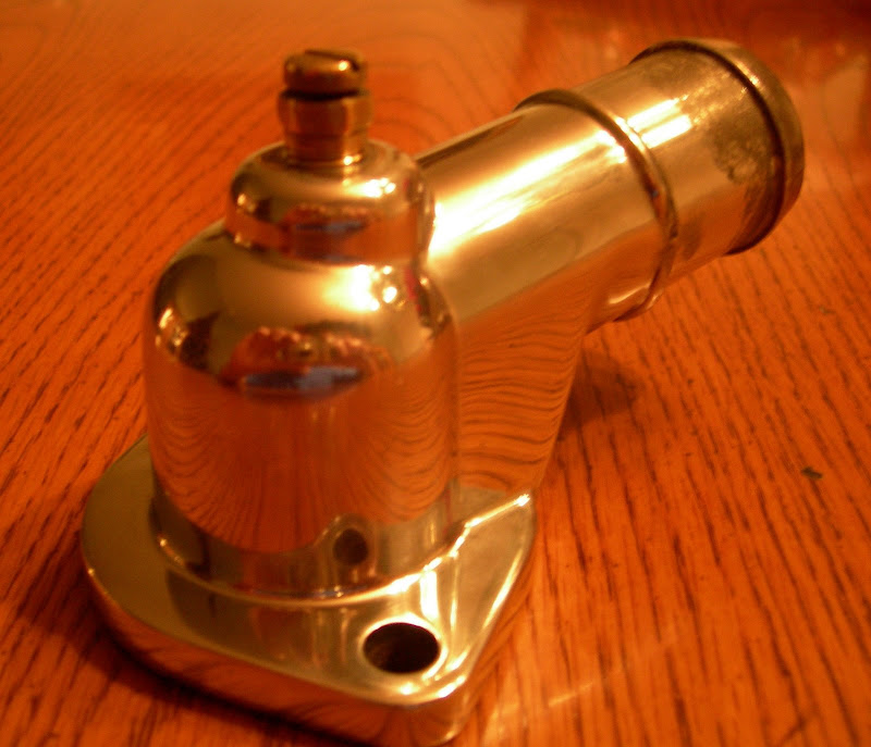

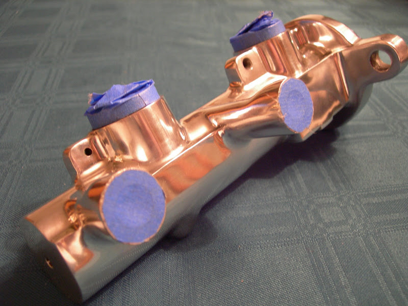

95naSTA Posted May 22, 2008 Report Posted May 22, 2008 I got these GP cross laces about a year ago.. At the time I owned a beater 90' Regal Custom and I was looking to get into another 95 Bonneville. I had one previously but was involved in an accident which totalled it.. I knew these were the wheels I really wanted down the line so I just grabbed them. They were gold with a polished lip and in OK shape.. The intention was to strip the gold and paint the cross lace part black. It would make for a real nice look and stance. Especially with the wider rim (8" vs. the Bonnie's 7") and lower offest.. When I picked my new car up, the tires were in good shape so I didn't bother to do anything with the wheels.. Fast forward 10k later and it's about time to get on that. Here is a couple pics of the car: I got pretty decent at polishing aluminum earlier this year (Master Cylinder, Thermostat Housing) but stopped due to hand surgery. Now that my hand is somewhat ok I can re-polish the lip on the wheels and get them power coated. I had the powder coating place strip the gold/clear and I started polishing them this week. Enough babbling.. On to progress pics: This wheel was in the worst shape out of all of them. I had to start from 220 grit in some areas and even 180 on others because the oxidation penetrated deep into the aluminum.. It took me 2.5 hours to get the outer lip and center cap lip to a 320 grit finish. After that it took an hour to work through 400, 500, 600, 800, 1000, and 1200 grits. All hand sanding btw.. After a quick pass with a cloth wheel bit on the die grinder and some aluminum polish, this is what I got: Here's what one of the unfinished rims looks like. The one above was in much much worse shape. And here is one I'm almost finished from the other day. I have to go over the very outside of it and then go over it again with polishing wheel. This one was a little easier. It took 3 hours to get it to this: Hopefully I can get the polishing done by next week sometime. The powder coating will be done shortly after. A nice high gloss black on the lace section and center caps then clear to seal the polished center ring and the outer lip. I thought some of you guys would like to see these being brought back to life. Quote
