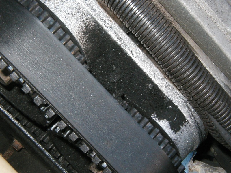

spiderw31 Posted January 20, 2008 Author Report Posted January 20, 2008 Ok, just pulled the front cover off, and the timing belt is definately not broken. It is tight between the cam sprockets, and it turns when I crank the engine. However, the belt doesn't look like it is all that great shape. The back of the belt is glazed pretty badly is a couple spots, and the teeth on the belt are kinda worn down. Since a picture is worth a thousand words, here ya go: It is 15* outside right now, so I'm not gonna be spending much time out there today; I'll dig deeper tomorrow. At this point, I'm thinking that the belt jumped. Short of tearing the whole system open, is there any easy way to tell if this is the case? Turbo231: I don't have away to check the fuel pressure right now, but I can hear the pump run for a few seconds after I turn the key. In addition, after cranking a bit, the pump does run again, so for now I will assume there is pressure. is there a schrader valve that I can check pressure at? Quote
Psych0matt Posted January 20, 2008 Report Posted January 20, 2008 the belt jumping is definitely possible. Have someone turn it over while watching it, your tensioner may have crapped out too. There is the possibility that it is tight between the sprockets, but it could be just the sprocket tension holding the belt tight, not the tensioner doing it's job. Have someone do that and watch it, you'll definitely know wether it's loose like that or not Quote
