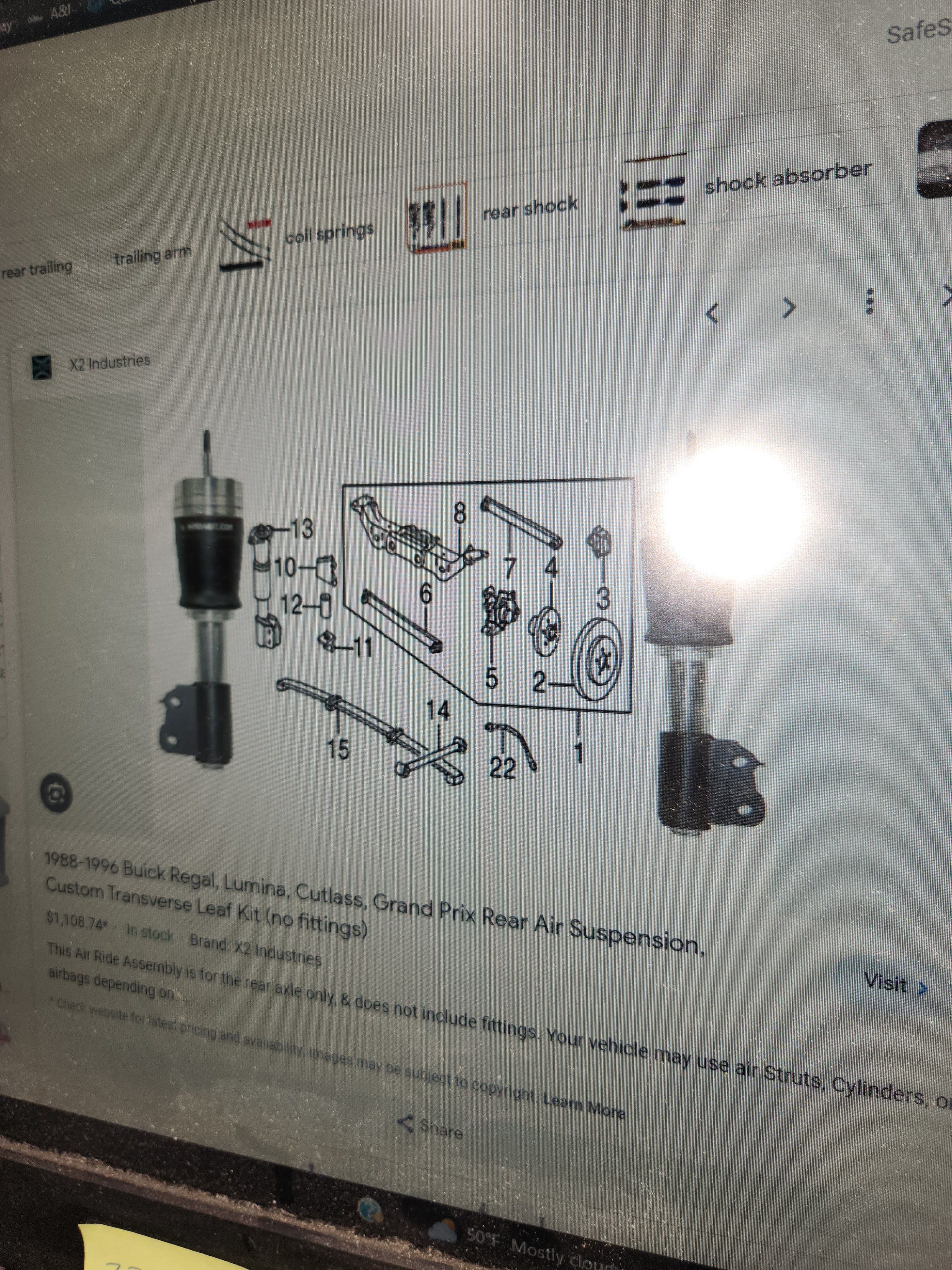

Go4DaMo Posted November 10, 2023 Report Posted November 10, 2023 All I want is for my 1st gen FE3 sport suspension not to sag like a bitch on my '93 Z34. ANYBODY have an 88-91 monoleaf? That seems to be the only way these cars dont SQUAT. It drives me nuts. At least the 245/50s on Xlaces mask the squat now. But, damn, GM really skimped out in 92 when they changed manufacturers to a cheaper monoleaf that started creeping after 10 years. I got stoked when I saw this. Then, I realized it would need a compressor, etc. I had air SHOCKS on my 1st pickup truck, which I enjoyed. I could pump them up at a gas station air compressor when it was under load, etc. Doubt anything like that ever existed for a 1st gen, especially now... Quote
Go4DaMo Posted November 10, 2023 Report Posted November 10, 2023 Would this Park Avenue application work using the old school Schrader valve to add air manually? It APPEARS the same as a W-Body. Wondering if anyone knows about the fitment. Thanks. Amazon.com: Monroe Shocks & Struts Quick-Strut 171798 Strut and Coil Spring Assembly : Automotive Quote
