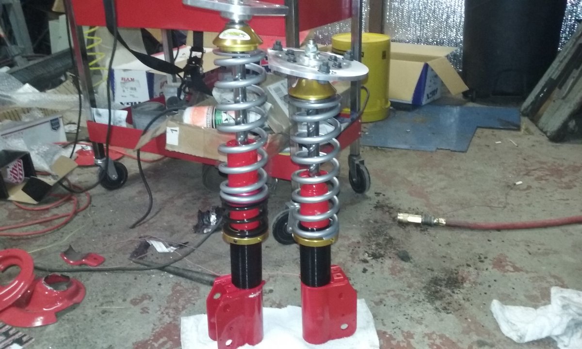

MemphisMan Posted February 1, 2019 Report Posted February 1, 2019 44 minutes ago, Xore said: All these are discontinued, anything new..I just got a 93 z34 auto. Want to drop it at least 2in. But I cant find anything..I need help. Thank you Welcome. Is your Z34 white by chance? Post up some pics in the new members section and tell us a little about it. http://www.w-body.com/topic/47477-lowered-the-front-of-my-cutty/ is a good place to start for the front. I used this on my first wbody and am getting ready to do it to my second one. https://www.w-body.com/topic/55347-lowered-the-rear-of-my-cutty/ shows the parts list needed for building coil overs for the rear. Getting ready to do this again too, but this time I'm going to take more pics and provide a more detailed write-up. It's super easy. Selenoyl 1 Quote
Amanita Posted February 1, 2019 Report Posted February 1, 2019 (edited) 3 hours ago, MemphisMan said: Welcome. Is your Z34 white by chance? Post up some pics in the new members section and tell us a little about it. http://www.w-body.com/topic/47477-lowered-the-front-of-my-cutty/ is a good place to start for the front. I used this on my first wbody and am getting ready to do it to my second one. https://www.w-body.com/topic/55347-lowered-the-rear-of-my-cutty/ shows the parts list needed for building coil overs for the rear. Getting ready to do this again too, but this time I'm going to take more pics and provide a more detailed write-up. It's super easy. Could you specifically take plenty of pictures with how they are mounted to the strut towers? I'm strongly considering giving the rear of my 96 Coil Overs and I want to make sure I get that absolutely right. Edited February 1, 2019 by Amanita Quote
MemphisMan Posted February 1, 2019 Report Posted February 1, 2019 10 hours ago, Amanita said: Could you specifically take plenty of pictures with how they are mounted to the strut towers? I'm strongly considering giving the rear of my 96 Coil Overs and I want to make sure I get that absolutely right. Sure will. Just FYI, the stock top mounts are reused on the coil overs so they bolt up with the same two bolts. What I really want to photograph is the removal of the monoleaf. Maybe even take a video of the releasing of the tension on it. Quote

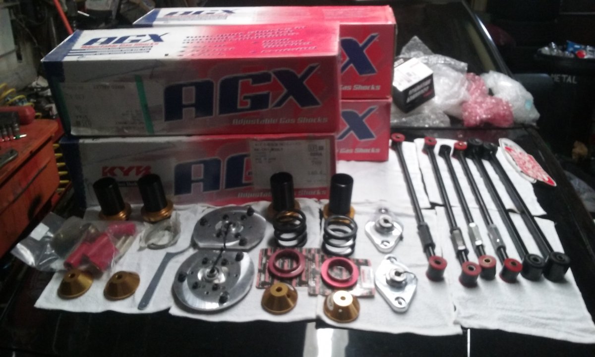

Imp558 Posted February 1, 2019 Report Posted February 1, 2019 You guys know about these right? They're beautiful, I have a full set. Quote
Amanita Posted February 1, 2019 Report Posted February 1, 2019 (edited) 52 minutes ago, Imp558 said: You guys know about these right? They're beautiful, I have a full set. I'd like to get a set for the front in the future. How have those treated you? Do you have a parts list for what you used? Edited February 1, 2019 by Amanita Quote
Imp558 Posted February 1, 2019 Report Posted February 1, 2019 My suspension is from space, custom a-arms to allow second gen spindles and stuff. A bunch of shit you probably don't want to deal with. The quality of Jarek's mounts is outstanding, just holding one is awe inspiring. It's not in yet so I can't comment on the performance and durability but I'm going to start that swap this month. Amanita 1 Quote
Amanita Posted February 1, 2019 Report Posted February 1, 2019 (edited) 31 minutes ago, Imp558 said: My suspension is from space, custom a-arms to allow second gen spindles and stuff. A bunch of shit you probably don't want to deal with. The quality of Jarek's mounts is outstanding, just holding one is awe inspiring. It's not in yet so I can't comment on the performance and durability but I'm going to start that swap this month. I'm looking at getting some new KYB struts for the rear soon (part number is 236003), I'd be able to use those with these mounts right? I'd hate to have to buy a new set in order to use them. Also I'm looking forward to seeing the results of that swap, good luck! Edited February 1, 2019 by Amanita Quote
Imp558 Posted February 1, 2019 Report Posted February 1, 2019 KYB AGX struts are a bizarre diameter. You have to tell Jarek so he can accommodate the shaft and then buy an odd size sleeve and seat that don't quite fit unless you put some tape or something on the strut first. I wanted those front and rear so I had a-arms modified to put second gen struts up front since they don't have a cartridge option. If you look around there's a thread I updated regarding poly bushings in the A-arms too. Quote
