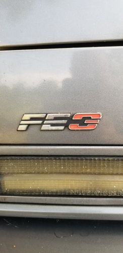

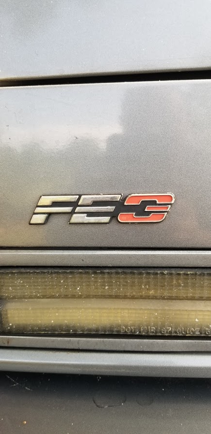

GoldSupreme95 Posted May 2, 2021 Report Posted May 2, 2021 I have a '90 Cutlass Supreme SL Sedan with 18,000 original miles. Fully optioned out with the FE3 suspension. I am attempting to determine exactly what the FE3 suspensions consisted of on these cars. I see many different specs quoted online. I want to replace the rear struts because they are 31 years old. Any opinions or suggestions will really help. rich_e777 1 Quote
GTP091 Posted May 4, 2021 Report Posted May 4, 2021 (edited) You dug up a 20 year old thread so can’t suggest you search for your answer. Not sure if these differences are really written down anywhere official as it’s just considered an upgrade over the base equipment. FE3 has a thicker front sway bar (34mm), I think FE1 is around 25mm. Actually has a rear sway bar, non FE3 cars do not; back then hat was not standard equipment. A base cutlass will have base FE1 options, the supreme would be FE3. Just make sure to select cutlass supreme in your parts quest and it should give you the right list if you can find parts. Rock auto is really your best shot. Dealer has had nothing for a very long time and the wholesaler dealer sites will just have brake pads and rotors and other consumables. Our cars were new when the internet was dial up so very little archived info to locate. If you're looking to change out the struts the OEM gm parts from what I recall are just acdelcos that are actually rebadged brand name units. Similar to old school Monroe sensatrac quality but that’s not what they were. If you want to keep it better or similar to FE3 quality you would want to find some new old stock KYB’s. I have em on my 91 GTP and handles very well for 30 year old domestic. Don’t waste to much money on trying to squeeze performance out of your car as there’s no support for us in the aftermarket, never was 20 years ago. Best to focus on making it look good they’re antiques now after all. Edited May 4, 2021 by GTP091 Quote
