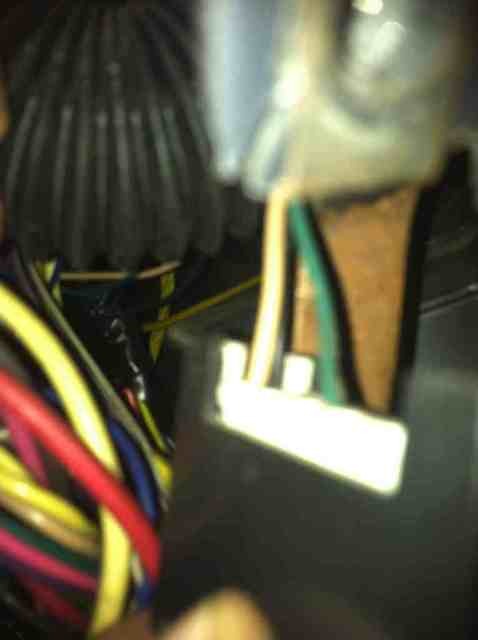

Luke94vert Posted August 26, 2012 Report Posted August 26, 2012 I'm finally getting around to installing this. But when I went to run the tach wire I have no orangish wire there. There is only 3 wires. Green wire and black. Now what do I do? Quote
Luke94vert Posted August 26, 2012 Report Posted August 26, 2012 Nevermind. I got it. Some times I second guess my self too much. Quote
