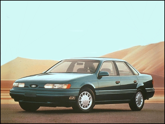

White93z34 Posted December 2, 2006 Author Report Posted December 2, 2006 here, its the light in front of the front wheel. i'm thinking the only decent place to install it on a lumina is the front corner houseing. thanks for the atricle that definately at least gives me a starting point. Quote

1990lumina Posted December 2, 2006 Report Posted December 2, 2006 No, only the earlier Taurus's have them...my dad's '95 doesn't have one. I think the last year for that was '93 (I noticed that's a '93 Taurus, body colored bumpers, unlike the '92, but still has black door handles)....until it's some wierd U.S. only feature. Does the side marker light flash on that Taurus?? The one of my dad's does...so maybe they changed the location of it later My dad's volvo has lights that flash on every fucking thing lol....two in the front, and two on the sides..and of course the rear tail lights Quote

White93z34 Posted December 3, 2006 Author Report Posted December 3, 2006 i think only the higher end taurus' got them, as the one i've been driving is a prety well equiped LX wagon, in fact most of the early 90s taurus' i've seen don't have that at all. i think the only real way for it to work for me would be to goto the steering column turnsignal switch and get a positive lead or at least a relay lead off the turnsignal switch as it would flash otherwise. Quote
