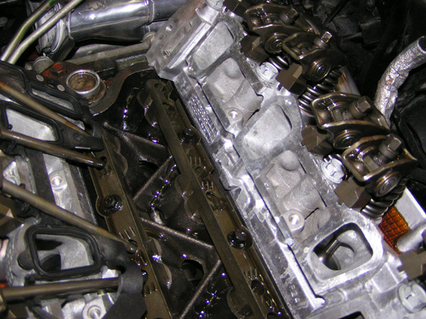

mfewtrail Posted October 25, 2006 Report Posted October 25, 2006 Fulcrum roller rockers are where they mount to the stud. GM never put any of that in any 60*v6. I dont even think you can get fulcrum roller rockers without the tip being a roller as well. The ones on the '96+ 3100's are roller tipped rockers. They have a roller where the vavle is. There are no factory roller tip rocker arms in 3100's, the 96+ got roller fulcrum rocker arms as I stated. Here's a picture in which you can clearly see the fulcrum is a roller type setup and the tips are stamped. http://www.domesticcrew.com/colin/Diagnosis/LIM01.jpg Quote
Guest TurboSedan Posted October 25, 2006 Report Posted October 25, 2006 Fulcrum roller rockers are where they mount to the stud. GM never put any of that in any 60*v6. I dont even think you can get fulcrum roller rockers without the tip being a roller as well. The ones on the '96+ 3100's are roller tipped rockers. They have a roller where the vavle is. yeah, you have it backwards. Quote
19Cutlass94 Posted October 25, 2006 Report Posted October 25, 2006 I could have sworn it was thw other way. My bad. Sorry. Quote
