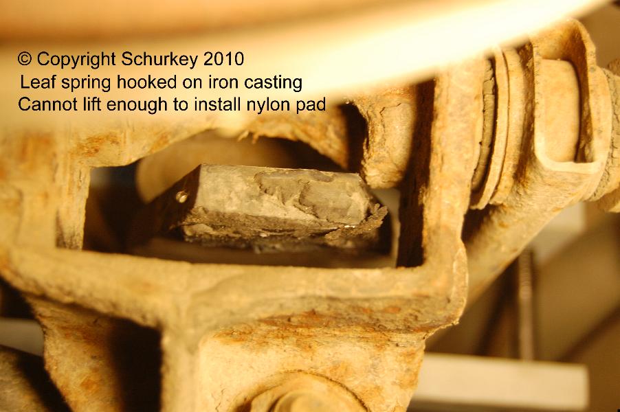

Schurkey Posted December 24, 2010 Report Posted December 24, 2010 (edited) Finished the second Lumina today. Actually had MORE problems with it than the first one. I think I've figured out why some folks have to beat the living crap out of the nylon pads to get 'em to snap into place. The end of the leaf spring may not be centered on the iron casting; and it becomes trapped in place by the hub carrier. There is no room for it to move upward so the pad can slide in. I poked a tapered pry-bar between the spring and the rear lateral arm; I don't know if I moved the spring or the hub carrier--but--with the spring out from under the edge of the iron casting, the nylon block snaps in MUCH more easily! This is the tip of the spring, catching on the iron casting. See how it isn't centered in the casting--too far to the rear. Edited July 2, 2024 by Schurkey Quote
