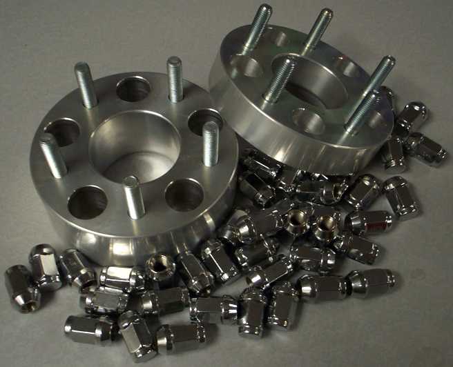

mfewtrail Posted November 14, 2005 Report Posted November 14, 2005 I found this info for what it's worth.... "Slip-on Spacers These are the discs that slide over your studs. For small thicknesses (1/4" or less) they are fine. For greater thicknesses, the wheel studs are seriously weakened. The reason is that the studs have a greater bending moment since the lugnuts are further away. Under braking or acceleration, the studs would be stressed more, and might break. Bolt-on Adapters Billet adapters bolt onto the car just as a wheel would. The adapters have their own studs that the rim bolts onto. This design is just as strong as without adapters, since the stud forces haven't changed. The adapters are made from a billet cylinder of 6061 T6 Aluminum. The billet is machined to fit over the hub, with stud holes drilled to fit. Studs are pressed through the adapter to which the rims are bolted onto. The adapter is then slipped over the car's studs and bolted on. The rims finally bolt on as usual. " http://www.skulte.com/billet_adapters_lg.jpg Here's the main page there. http://www.skulte.com/adapters.html Quote
GnatGoSplat Posted November 14, 2005 Report Posted November 14, 2005 Sounds like you will definitely need bolt-on adapters. Stock offset is +25mm, btw. Quote
lakefxgp96 Posted November 14, 2005 Author Report Posted November 14, 2005 \ said: Sounds like you will definitely need bolt-on adapters.Stock offset is +25mm, btw. You are correct, +32 is the non b4u i think ? doesnt matter, i want something better than +25 So would it be safer to use an 'adapter' than longer studs? I would think so too but want to make sure. Quote
GnatGoSplat Posted November 14, 2005 Report Posted November 14, 2005 Yeah, if you really want at least 1", I think adapters will be considerably safer. Get hubcentric ones if you can. Quote
