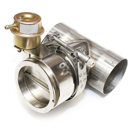

Guest TurboSedan Posted November 5, 2005 Report Posted November 5, 2005 what i am thinking i will do is go with ATP's boost activated cut-out. i could leave the rest of the exhaust system like it is now. basically....use a grainger valve MBC to operate the cut-out's actuator...hit 10psi and wham-o! take-off like a bat out of hell while your car ROARS to life! meanwhile the car is quiet for daily driving...so long as you don't hit 10psi (or whatever you set the g-valve to open up the cut-out) kind of funny seeing a wastegate can sitting under the car....ATP has so much cool shit.... Quote
Guest TurboSedan Posted November 5, 2005 Report Posted November 5, 2005 http://www.atpturbo.com/Merchant2/merchant.mvc?Screen=PROD&Product_Code=ATP-ACS-010&Category_Code=BCS VES is $235, plus a $25 grainger valve MBC you can get from places like M&M Racing. seriously, if i were to get this, i would likely remove my glasspack and go with a stock (quiet) muffler and add a cat after the VES. no need for fake duals, bigger piping, or mandrel bends. this is the sleeper way of going with a large turbo exhaust. and hell, for that matter, i might even go more sleeper yet and quiet down my turbo by going with longer CAI piping instead of cone filter directly on compressor, and go with an ATP RS modular BOV that i could vent back to the intake stream for quiet operation. the TurboXS RFL BOV i'm using right now has a huge air horn that screams "this car is turbocharged!" which kind of contradicts the car's appearance. Quote
