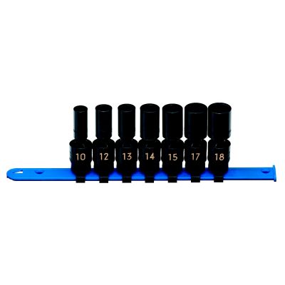

sdwhite Posted October 13, 2005 Author Report Posted October 13, 2005 HOLY CRAP! $250 for 7 sockets. Don't think I'll be getting those soon. Yea...GM people didn't know. They asked for the VIN so I figgered it would be indicated there somehow...made trip to garage to get it. They still couldn't figure it out. Had to go back to the garage to pull a valve cover off to check. I was NOT happy. This one was MFG in 10/94. Not sure when production started...would this be considered early or late? Yes... I didn't find out until a day ago to use new bolts @ 60degreev6.com I hope the previous owner/dufus didn't break one of them off! Does anyone have the part numbers for those bolts? Quote
