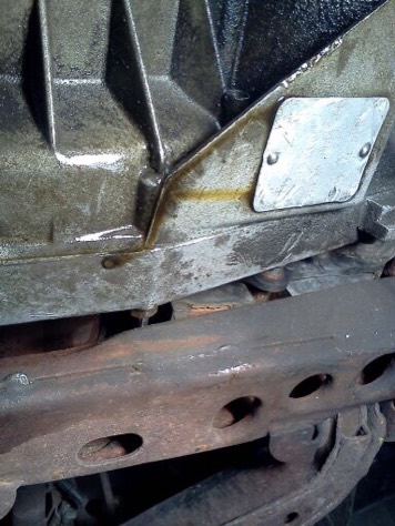

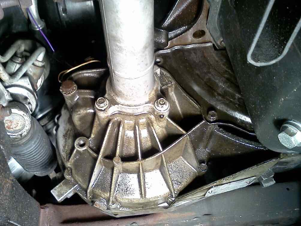

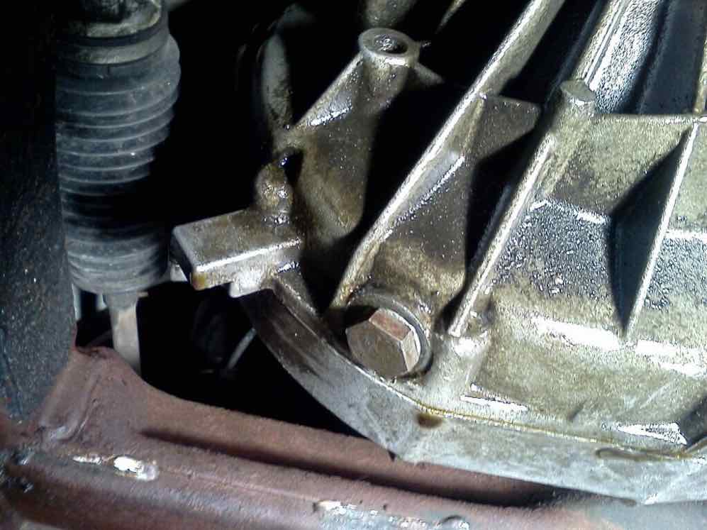

Go4DaMo Posted October 17, 2014 Report Posted October 17, 2014 Been having a puddle under my Zed...found out it's from my Getrag. Can anyone with a PC be able to tell from the pictures I took where it's leaking? I degreased & hosed down the fluid-bathed belly of her, then parked it for a week before taking photos. Fluid's $10+ a quart, but I'm more concerned with whether or not the parts are available or whether I can do the work myself (pending the time, knowledge, & tools required). Any help would be appreciated. I add fluid 2-3 times/ month. Sent from my iPhone Quote

19Cutlass94 Posted October 17, 2014 Report Posted October 17, 2014 Is your clutch slipping? That's looks exactly like mine when the input shaft seal went. Sent from my iPhone Quote

Go4DaMo Posted October 25, 2014 Report Posted October 25, 2014 Clutch isn't slipping. Nunzi says his does the same thing. Quote
19Cutlass94 Posted October 25, 2014 Report Posted October 25, 2014 Theres not many places that fluid can leak from. Theres the seal or silicone between the two halves, the drain plug, the fill, the input shaft seal, and the detent cover, and the o-ring for the intermediate shaft goes. Other than that theres no other places that fluid can come out right there. Although it was leaking from the input shaft seal, or the detent cover, the clutch would start slipping soon after. Especially with that much fluid coming out. Id clean everything up real good, take off that flywheel plate or whatever its called and take a look up into the clutch area. If you left the car running would it leak, or does it only seem to leak while driving down the road? Quote
carkhz316 Posted October 26, 2014 Report Posted October 26, 2014 Try some dye. It will probably work to pinpoint it. I guess that's what I would do if you're frequently adding fluid. Quote
Go4DaMo Posted October 26, 2014 Report Posted October 26, 2014 It leaks whether it's running or not. Clutch isn't slipping. Thanks for the suggestions ! Quote
