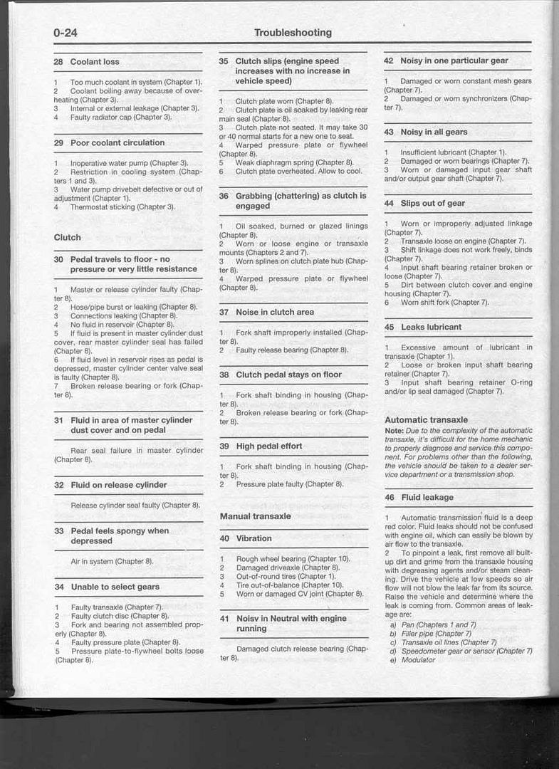

Okay..first I scanned the troubleshooting page..on this page it talks about possible reasons why she is popping out of gear (it is on this page somewhere):
http://img.photobucket.com/albums/v664/1990lumina/storm/5.jpg

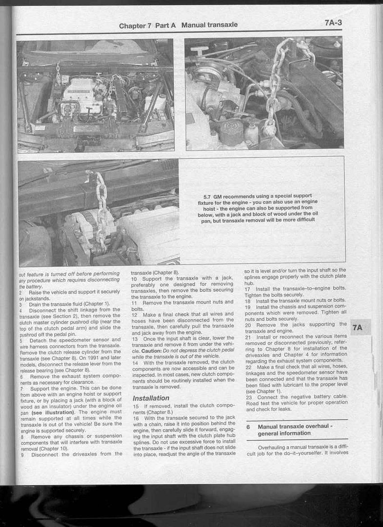

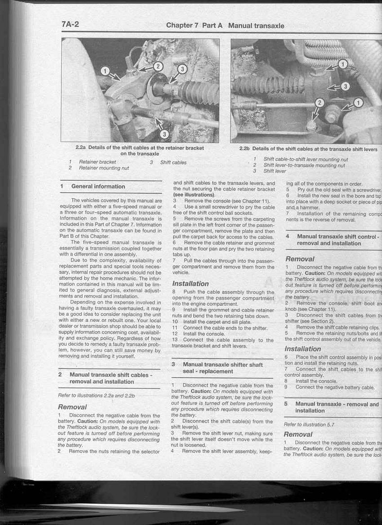

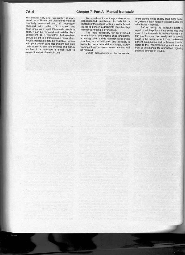

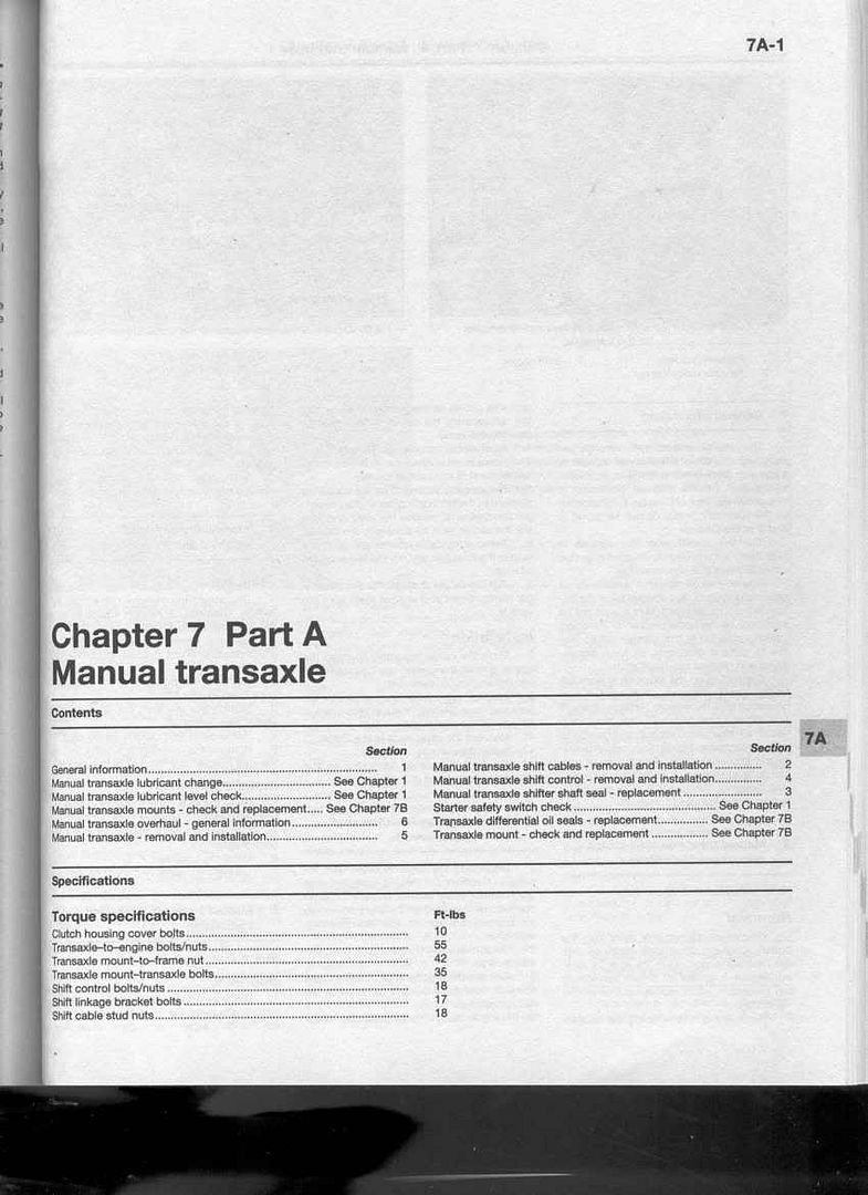

Then I scanned the whole chapter (only 4 pages) on the manual transmission. It talks about the shift forks and stuff in there..but it doesn't say how to rebuild the tranny:
http://img.photobucket.com/albums/v664/1990lumina/storm/1.jpg
http://img.photobucket.com/albums/v664/1990lumina/storm/2.jpg
http://img.photobucket.com/albums/v664/1990lumina/storm/3.jpg
http://img.photobucket.com/albums/v664/1990lumina/storm/4.jpg
Sorry about the fairly bad quality...photobucket reduced the quality when I uploaded them because all the pages were 500kb each and I'm only allowed 250kb with this free account lol...they are also quite large..

i wonder why the diagnosis page refers to improperly adjusted shift cables when they are non-adjustable
