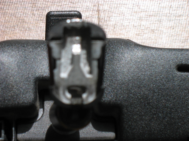

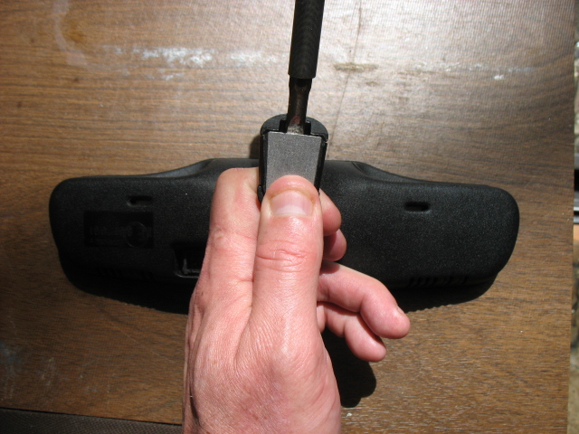

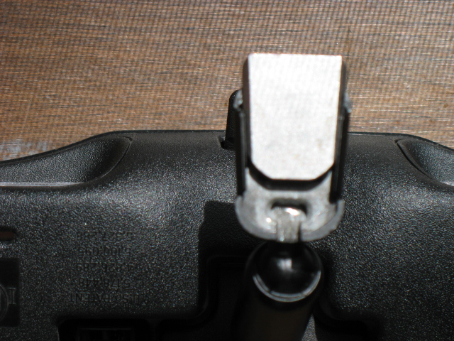

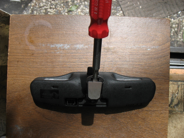

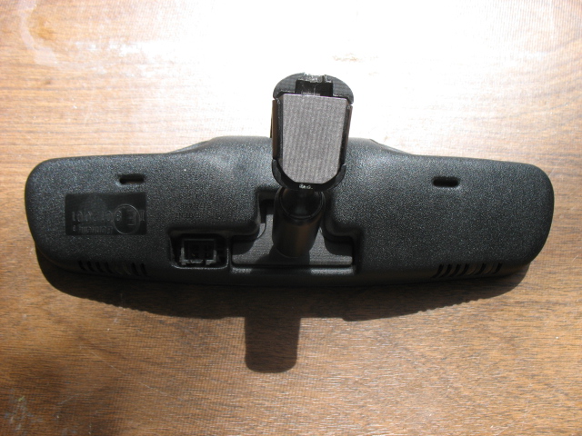

bobbymacbean Posted April 2, 2011 Report Posted April 2, 2011 Removing the button/plate mount from a rear view mirror that has fallen off of the windshield for specifically a 1997 Oldsmobile Cultass but probably has wide range of applications for GM vehicles of that period. If you want information about removing an existing rear view mirror that is still attached to the windshield, you will find that info using google. Mine just disconnected by itself. This is for a Donnelly IE 8012001 rear view mirror with dual map lights. First, mark the windshield on the outside so that you'll know exactly where to reattach the button/plate when you're ready and then disconnect the wiring. It is a simple plug in mechanism much like a phone connector you would plug into a wall jack except there is no external tab release as there is on a phone connector. You will need a screwdriver to manipulate the release tab. Removing button/base plate from rear view mirror for reattaching to windshield. The base plate is horseshoe shaped wedge that will slide out of the mounting bracket. There is no screw connecting it to the mounting bracket. You will need to use a screwdriver at the wide end of the plate to lift it up so that it will clear the lip that holds it in place. With one hand, lift the wide end up and with the other hand slide the plate towards the screwdriver. This will require quite a bit of pressure and the plate may fly out of your grasp so you will want to do this where it won't end up underneath a piece of furniture or lost in other materials in the room. You are now ready to use a rear view mirror adhesive kit to reapply the button/plate to the windshield. Be sure to follow all of the instructions for removing remaining residue from the windshield and the button/plate and cleaning the windshield before applying the adhesive. A razor blade will be very useful for this. Quote

bobbymacbean Posted June 22, 2011 Report Posted June 22, 2011 I'm glad he did post it, because it JUST helped me with a mirror that fell off the other day. Although, I can't seem to get the wiring unplugged so the mirror is still dangling. Hi dalydose - If you're familiar with conventional land line phones, the plug that goes into the wall and the plug that goes into the phone both have tabs that have to be released in order to disconnect the the plugs. Disconnecting the rearview mirror is the same principle except with the phone jacks, the tab sticks out so you can do it with your fingertips. That's not the case with the mirror. Again, you'll have to use a screwdriver. I think you have to get under the tab and lift up but it might be the opposite. Can't remember for sure but I'd try slipping the flat head screwdriver under the tab and lifting up while at the same time gently trying to pull it out of the socket. Just in case anybody is still confused, the text stating that there is a screw involved for the mirror that is pictured with the text is incorrect. There is no screw. The metal piece has to be lifted with a screwdriver and slid out of the slot. @ ManicMechanic - this is precisely why I posted on a 6 year old thread. It just happened to me for the first time a couple of months ago and this thread had some confusion about how to work with it. This is a problem that is going to get more and more prevalent not less, so it's relevance will only increase as opposed to it being obsolete info. There's thousands of these older vehicles with this type of mirror adhesive and the older they get, the more frequently this will occur. It was a little time consuming doing it but I'm pretty sure it was worth the effort and hopefully it will save some other people a few hours trying to sift through unclear or useless info. Hope that satisfies your confusion. Quote
