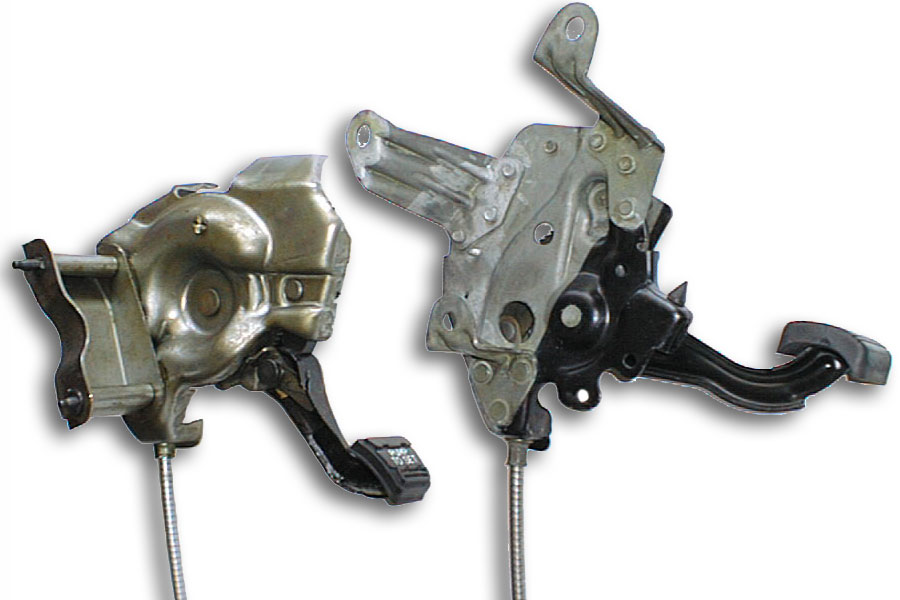

Left side view (fender side).
Left: 1988-93 lever assembly
Right: 1994-99 lever assembly

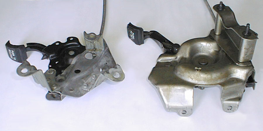

Rear/Left side view (fender side).

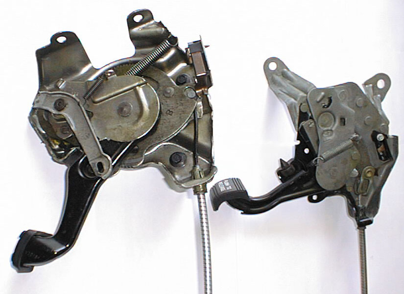

Front/Left side view (fender side).

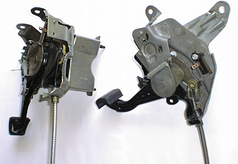

Top/Left side view (fender side).
Left: 1994-99 lever assembly
Right: 1988-93 lever assembly

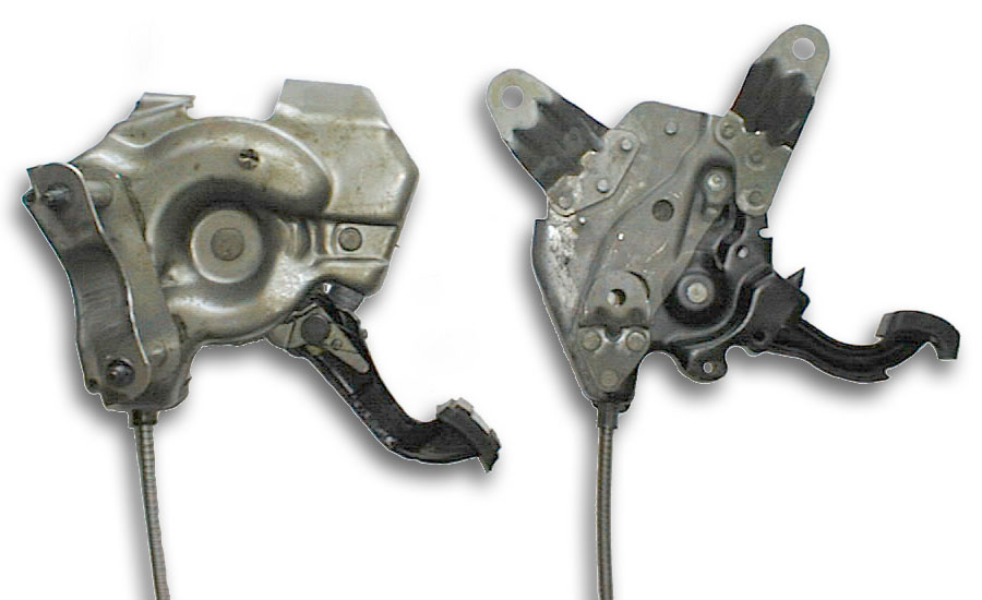

Front/Right side view (inside).
Left: 88-93 lever assembly
Right: 94-99 lever assembly

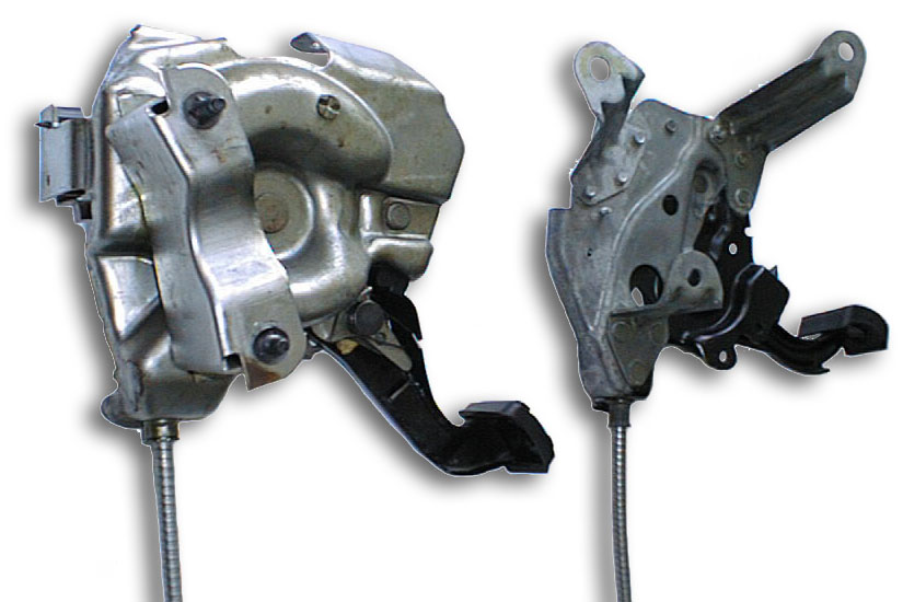

Rear/Right side view (inside).
