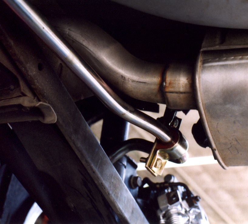

"Addco Swaybar meets 2.5" custom exhaust" - picture courtesy of Kevin Heider
Here is what the rear 7/8" Addco sway bar looks like sitting underneath a custom bent 2.5" exhaust system. There is not a lot of space between the two. The Addco swaybar is listed at http://www.cyberauto.com under Chevy Lumina. It is part #474-U, $142.20. The Addco bar includes red polyurethane bushings.
