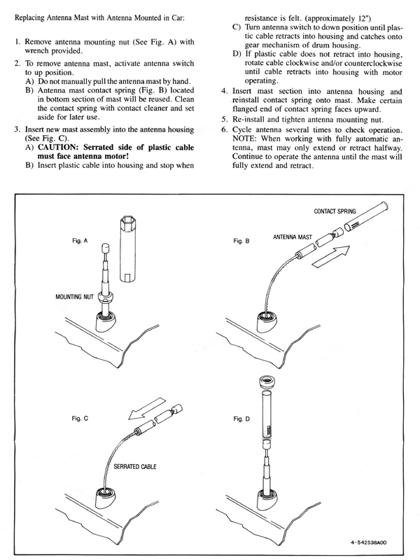

Part of the nylon cable from your old mast are likely to be stuck inside your power antenna unit. Usually it is not always necessary to remove the broken bits of old cable from inside the power antenna unit. A little bit of old nylon cable stuck inside the power antenna unit will not interfere with the operation of the new mast, however, if enough old cable is broken off inside the antenna or if you've replaced the antenna mast several times and there is a large quantity of broken cable inside, the antenna may have trouble retracting. If this is the case, you will have to remove the cover from the power antenna unit and pull out the remaining fragments of old nylon cable. On an 88-91, the front cover is held on by 4 phillips head screws, and one nut in the middle. On a 92-96, the front cover is held on by plastic rivets. Disassembling and reassembling the power antenna unit can be tedious, especially on a 92-96, so it would be a good idea to try installing the mast first and see if it can extend and retract without any trouble. If you do decide you need to extract the old cable bits, be sure not to lose any parts when you remove the front cover!
