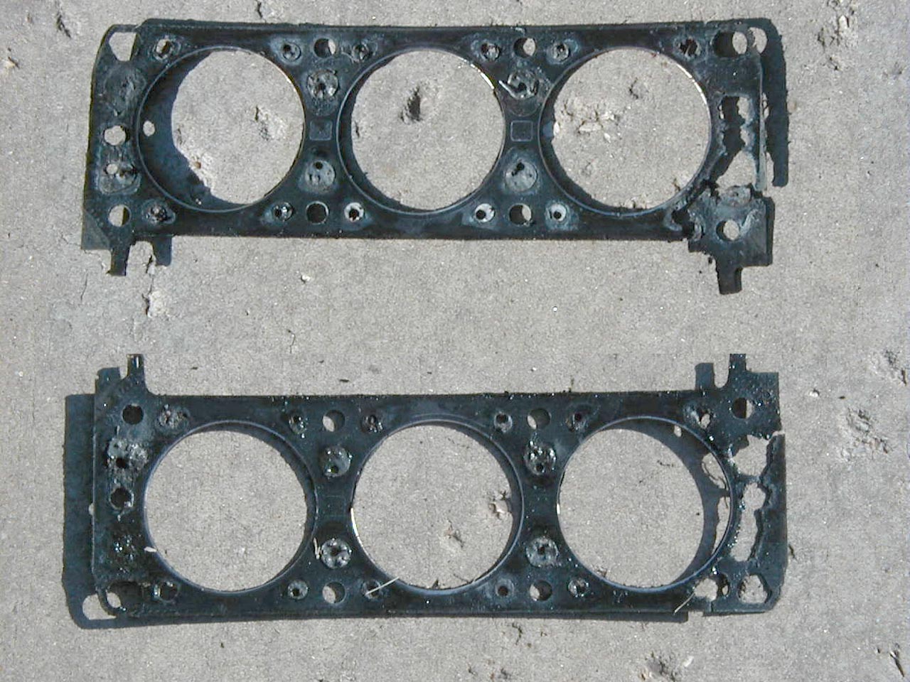

Whatever you do, do not neglect your car's cooling system! If your car has green coolant, it needs to be flushed and replaced at least once every other year, or once a year if you do a lot of city driving. This is because its anti-corrosion properties wear out after about one to two years. When this occurs, really nasty stuff can happen. For example, the head gaskets can start corroding from the inside out! This happened to me in late-1999. My car was leaking some coolant from a mysterious location. I'd put stop-leak in it, and that would fix it for maybe 4 months or so. Then finally, one day I noticed a huge puddle of coolant collecting under the car. I popped the hood open, and didn't see the source of the leak. I poured some more coolant in, and decided to start the car. I suddenly saw a small geyser of coolant gushing out of the head gasket. Head gasket work is very labor intensive, the heads, intake manifold, and everything on top of the engine must come off to replace it. The labor is several hundred dollars. Sometimes people sell older cars for next to nothing, or to junkyards, because the labor to replace the head gaskets is so high. It is definitely a good idea to do anything that you can to prevent head gasket problems.
Here's what BAD head gaskets look like. See where the head gasket has corroded away the coolant passages on the right? It caused a rather nasty external coolant leak. Both head gaskets were in equally poor condition. Click on the image to see more detail. This is an example of what head gaskets are supposed to look like!
